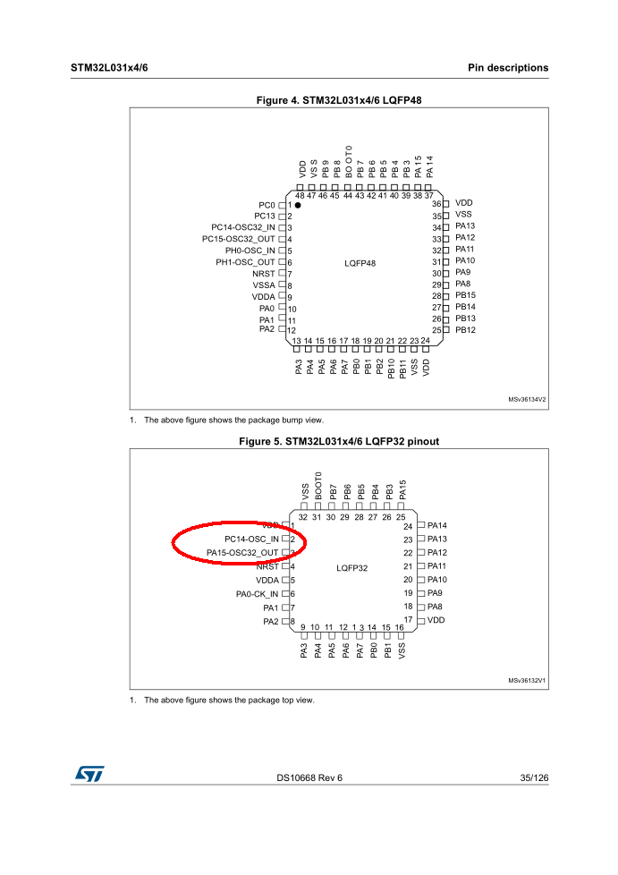

2021-02-15 3:05 AM
Both pins 2 and 3 are incorrectly described:
Maybe other 'L0xx DS are affected, too; I did not check.
2021-02-15 3:51 AM
Hello @Community member,
Thanks Jan for helping us to improve the ST documentation.
I will check.
Imen
