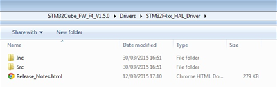

Hi yvraut.gerard,
All STM32Cube Packages contain HAL_Drivers Release_Notes file located in Hal driver folder: if you use STM32CubeF4 you can find it in this repository STM32Cube_FW_F4_V1.5.0\Drivers\STM32F4xx_HAL_Driver and the same for all STM32Cube packages.2015-03-31 1:09 AM
Hello Heisenberg,
This is exactly what i was looking for!!! I would suggest to make it more visible to user - copying it into the driver repository of every project created from MCube - Having an easy/obvious way to open it from MCube itelf Regards GerardWe’re moving the ST Community to a new platform to give you a better and more reliable community experience.
