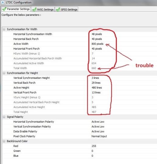

not working correctly setup window LTDC after opening already saved project
(see. screenshot)after generating the project is not the correct parameters are passed to the C-project:(2015-03-30 3:37 AM

project for version 4.6
However, 4.7 is identical Yes, the project had an initial generation parameters for LTDC default, after modifying the parameters are all displayed correctly and C-project also receives the correct settings LTDC. Project is saved. As described above, after the re-opening of the project there are problems ... :( ________________ Attachments : Open429.ioc : https://st--c.eu10.content.force.com/sfc/dist/version/download/?oid=00Db0000000YtG6&ids=0680X000006HzRI&d=%2Fa%2F0X0000000bLw%2FpvU9xLFxPeW9ZmwY_P.bmu87rTx1weECOVUE9yHZIB8&asPdf=falseWe’re moving the ST Community to a new platform to give you a better and more reliable community experience.
