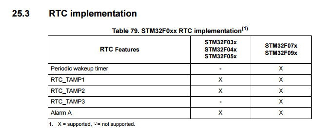

,The RM0091specifies in the ''3 RTC implementation'' table (page 577) the RTC Features supported by STM32F0 product Reference:

,Thank you, I missed that point..
