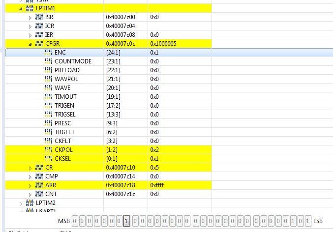

Really ODDBALL results. Like this setting gets me a count change on the falling edge of PC0 ( YES input 1) --- ONLY IF PC2 is LOW (One direction ??????)
This PCB is buried in an assembly so I cant see the top side of it at all. Think I'll try this on one that's not mounted and maybe this one has a solder blob on it in an aggravating spot....If you see a register setting that looks wrong, please don't hold back! They use the terms CLOCK, and Trigger and EXTERNAL INPUT and prescaler in so many questionable contexts that its difficult to sort out what conditions/settings are associated with what signal / pin and the encoder function itself. I figured if the thing was in ENCODER MODE (Like the register shows) then the device should be able to produce the count as shown in the RM0351.

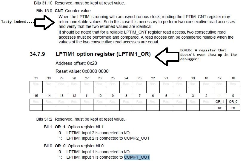

Here I've been tinkering with BIT EFFECTS so yeah CKSEL is a 1 and the manual says in a CAUTION NOTE at the bottom of page 1156 ''CKSEL bit must
be maintained to its reset value which is equal to ?0?.Than you have THIS:
Bit 0
CKSEL: Clock selector
The CKSEL bit selects which clock source the LPTIM will use:
0: LPTIM is clocked by internal clock source (APB clock or any of the embedded oscillators)
1: LPTIM is clocked by an external clock source through the LPTIM external Input1 ( ? )
I assume this timer is doing some CAPTURES based on the APB ''clock'' that I have selected as its ''CLOCK'' clock.
LPTIM external Input1 ? That nounage looks like one of the encoder leg INPUTS to me.

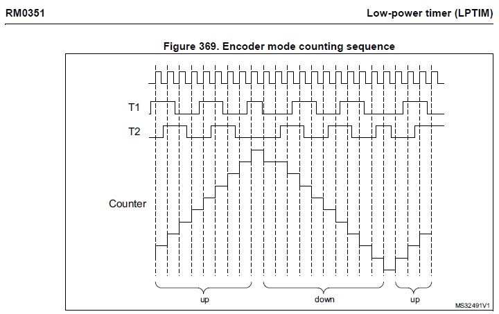

I have yet to get it to do THIS:
Yes I have looked (SCOPE) at this encoders output. THIS ONE is as shown in the above diagram with 1 leg change per click.
Timer 2 and 3 are happy with this same signal.
Some of the OTHER encoders I have seen will put out a full cycle of quadrature signal ( 2 up- 2 downs ) on each leg per click.
THAT was a surprise.... :\
I want it to work as the diagram shows. A COUNT CHANGE on EVERY EDGE..
