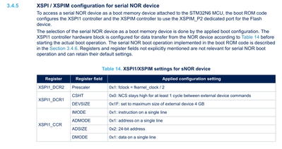

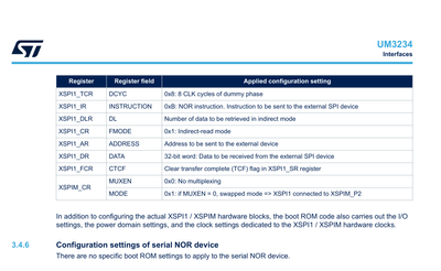

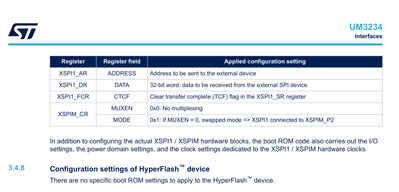

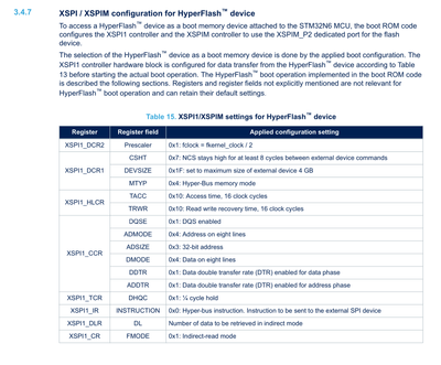

So i did find the info in
* UM3234 - How to proceed with boot ROM on STM32N6 MCUs
* Section 3.4
So i've included images of the pages.
It also looks like all these settings are fixed. There's no OTP setting to changes any of these values.
* Section 3.4
