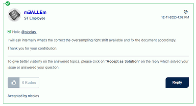

Hello @nicolas,
I will ask internally what's the correct the oversampling right shift available and fix the document accordingly.
Thank you for your contribution. Internal ticket 221624.
2025-11-18 2:02 AM
Sorry I need to unmark the solution until an answer is provided :)
