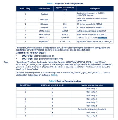

From my understanding if we want to make a dev board and use a different external memory that is not Octo SPI flash but just Quad SPI flash we shouldn't have to change any of the OTP registers.
Since
Most of this info is from the
No boot source is programmed in OTP default source is serial NOR
No configuration needed
Default settings for the XSPI from the ROM
Flash is the boot when Boot1 (low) Fairly curtain thats sNor flash.

Hello @Brenden_PLUS
Your understanding is correct.
By default, in Flash_Boot mode (BOOT0 = BOOT1 = 0), the STM32N6 BootROM configures XSPI1 on Port 2 in single‑SPI mode with the parameters defined in Table 14 of UM3234. This allows the system to boot and copy a signed FSBL binary into the internal AXISRAM2.
Afterwards, depending on the external NOR Flash memory you plan to use, the final configuration must be performed in your FSBL using the External Memory Manager middleware.
