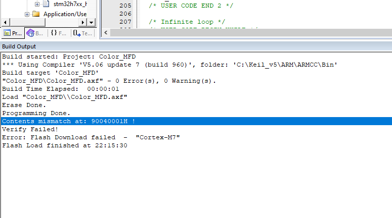

Hi, I'm trying to write an algorithm to load into external memory in QSPI_Dual_mode MT25QL512A for KEIL. I followed this instruction. The algorithm works BUT! when the firmware exceeds 90040001H an error occurs during verification. Smaller programs are flashed and work fine.

So failing 256 KB in
Either issue with Erasure, or content written incorrectly, or into the wrong location.
You can instrument the algorithm to output diagnostic info via a serial port
2024-03-06 2:00 PM
If you set “erase full chip” then the error disappears, apparently the problem is in erasing the sector, as I understand it, the algorithm erases only the first 2 sectors.

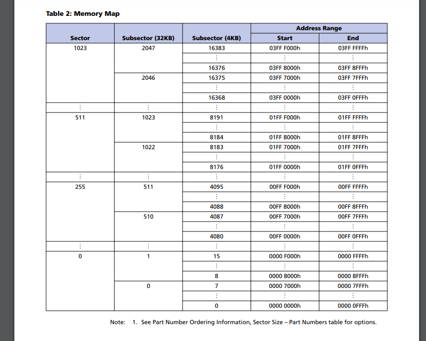

Not seeing anything egregious in there, perhaps a couple of things I'd approach differently.
BSP_QSPI_GetStatus() only checks one IC. Needs to read 2 bytes and check both
The erase block size will be 128KB, page write size is 512B for DUAL
Not immediately failing, so not an errant load (Winbond / Macronix) setting Block Protection bits.
