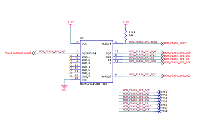

I have Segger Portable Flasher Plus and U-Flash application used to program STM32F777BI and it runs softly but when trying to download code to external flash I can not find where to point to external flash or where to add the flashing algorithm of external flash as it is custom with different pinout connections to microcontroller than standard ones. I already have .FLM and .stldr files of my custom external flash and tested them well.
DQ2 connected to PF7
DQ0 connected to PF8
DQ1 connected to PF9
DQ3 connected to PA1
Clk connected to PB2
CS connected to PB10
RST connected to PH6
Please advice
