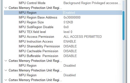

The configuration of Cubemx is as follows
The configured address is the address of SRAM1-3,given this configuration, why does "Strongly ordered memory" cause a HardFault
Thanks.

2024-03-06 12:20 AM
Is it because the address of sram1-3 cannot be "Strongly ordered"?
Why?

2024-03-06 1:24 AM
Hello,@Sarra.S
But it works when I set it to "TEX = 1 C = 0 B = 0 S = 0", shareability is disable,Why?
When I set it to "TEX = 0 C = 0 B = 0 S = 1",it is cannot work。
Thanks.

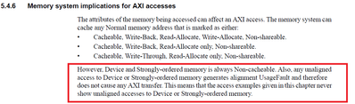

2024-03-06 1:47 AM - edited 2024-03-06 3:08 AM
Are you doing an Unaligned access to that memory region?
See: https://www.keil.com/support/docs/3777%20%20.htm
From ARM CM7 TRM:

2024-03-06 5:40 PM
Hello @mƎALLEm
Thank you for your reply 。
I read the "SCB->CFSR" register, and when set to "device" or "strongy-ordered", it is indeed 0x0100 0000, which indicates an "Unaligned access UsageFault" error according to the register interpretation!
Thanks!
