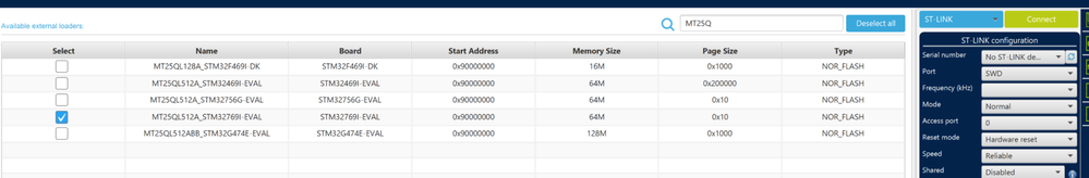

For the .stldr you mention (MT25QL512A_STM32769I-EVAL.stldr) is delivered only as a binary in current STM32CubeProgrammer packages ( picture below ) ; the full source for that specific loader is not published on the GitHub repo .
For a custom QSPI pinout (different from STM32769I‑EVAL), you typically need to:
