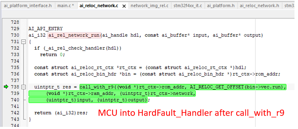

I'm testing running a relocatable binary model.
But when I use ai_rel_network_run(), I get into HardFault.
The detailed error information is as follows, with my current test code attached.
Hope that someone can help to resolve this issue!
Thanks.

static void AI_Run(float *pIn, float *pOut)
ai_i32 batch;
ai_error err;
ai_buffer *ai_input = net_info.inputs;
ai_buffer *ai_output = net_info.outputs;
ai_input[0].data = AI_HANDLE_PTR(pIn);
ai_output[0].data = AI_HANDLE_PTR(pOut);
batch = ai_rel_network_run(net, ai_input, ai_output);
if (batch != 1) {
err = ai_rel_network_get_error(net);

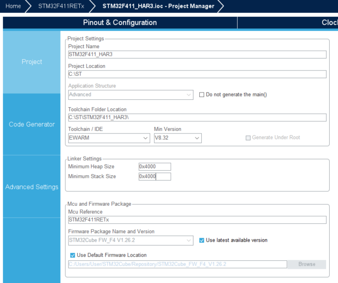

2022-09-27 2:42 AM
I had already increased both heap and stack size.
