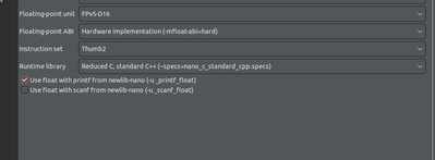

However, in the IDE, under Runtime library options, I have the following choices:
With the first option, the compilation fails because it can't find the asserts. I'm currently using the third option, but I encounter a hard fault when exiting the catch block.

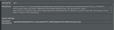

I've tried modifying the makefile, but some script seems to re-include the specs after building.

Use Standard C, Standard C++ to enable exception handling. What asserts can it not find?
