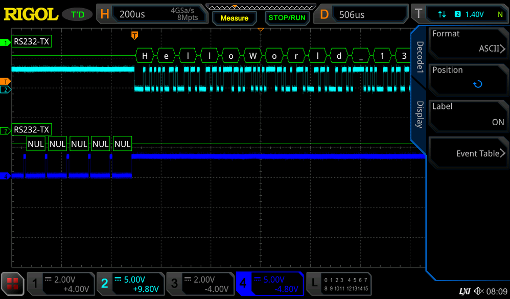

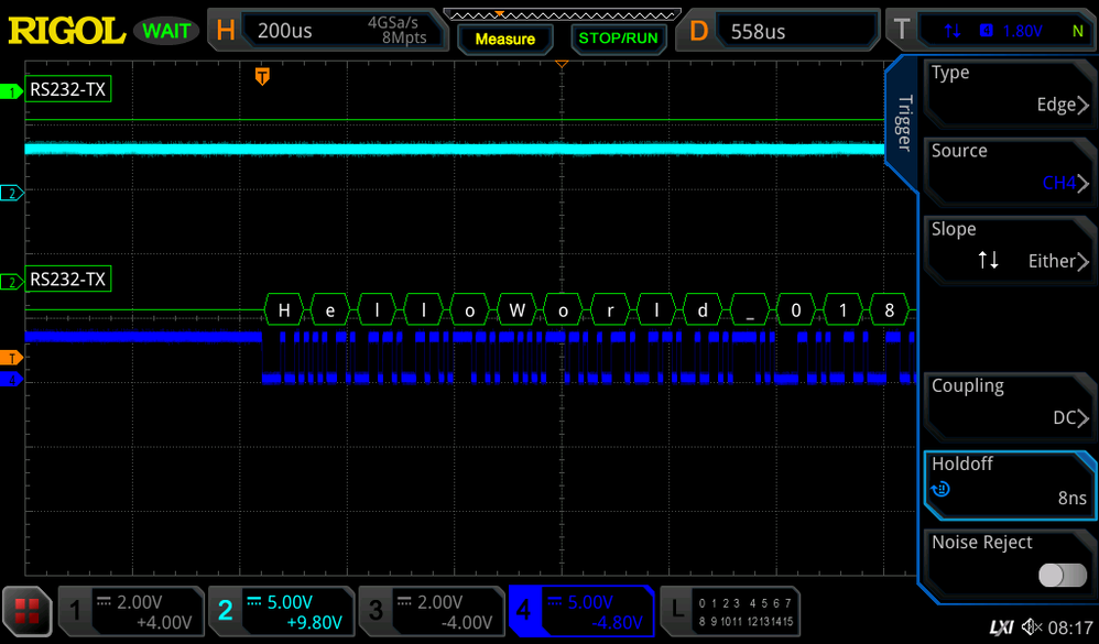

2022-09-25 11:24 PM
Hello Pavel, thanks for the answer. Attached some screen shots from the oscilloscope where I use a larger buffer and send the data roundrip from UART2 to UART9 and back from UART9 to UART2. There are no noises as I can see.
This is the receive buffer now with the first byte = 248d.
This byte is only received with USART2 and not seen on HW. Could this also be a problem in the HAL?
2022-09-26 2:05 PM
You show two TX lines (UART2 and 9?). Look at the RX line in the moment of enabling the UART.

2022-09-26 11:53 PM
The lines are connected as shown in the picture above. The HAL_UART_Receive_IT function is called long after initialization. Until receive, the signal level does not change at both pins. I will try to initialize with pulled up RX on USART2.
