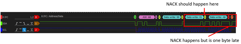

we have a setup where the STM32U375 MCU is the slave in I2C communication.
We want to NACK the host request on certain conditions.
We are internally using a register structure in the MCU and the host can send a read/write request via I2C to access the contents of the registers.
The current register address is handled internally by the firmware and automatically incremented on each byte written / read.
For example, if the requested register address is 0x0001, the host should not be allowed to write to the register but only to read it.
First we receive the one-byte device address, then the 2-byte register address.
After receiving the 2-byte register address, we can check if the host is allowed to read/write on this register and want to either ACK or NACK the communication on I2C1.
It seems when HAL_I2C_AddrCallback is called then it is already too late to NACK the current byte and the hardware has already ACK’ed it.
To generate the NACK so far, we have been using "__HAL_I2C_GENERATE_NACK()".

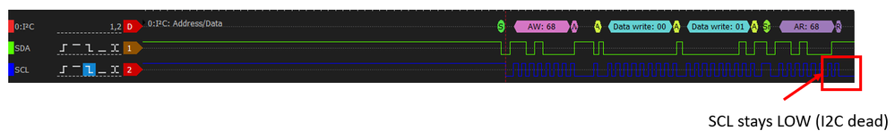

For a Host-Write to the MCU slave, this approach works fine except that the NACK is received by the host one byte late (see screenshot). This solution is not very clean and not preferred by us.For a Host-Read, this approach does not work. A NACK is never received by the host and the SCL line stays low afterwards, effectively having killed the I2C connection (see screenshot).
