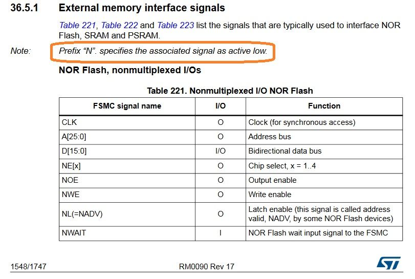

2018-09-12 4:41 PM
Do you mean the NEx signals are active low? Thanks for the tip, but I would like to see a reference to that in the datasheet or reference manual of the device.
So, there's a big chance to work out of the box, without extra logic? I believe it's worth a try. At least, if it didn't work, I guess I won't have problem accessing the first 64MB space of the M29EW flash chip.

2018-09-13 11:03 AM
Mr. Clive, you are our best reference of information over here. I just wanted you to show me where it was covered in the RM as I couldn't find it.
Anyways, I hope you bear with me a little bit and explain it with a bit more of details. From the M29EW datasheet, it seems the A[26:0] address inputs are ACTIVE HIGH. When write takes place on the top half (second 64MB sub-bank), FMC_NE1 goes high and this applies to A25 of the M29EW? Now, CE# is ACTIVE LOW for the M29EW. I can see now why AND is required on a pair of NEx signals, but I'm still confused regarding the "reconstructing" of the address bits as you suggested, and which goes to which?

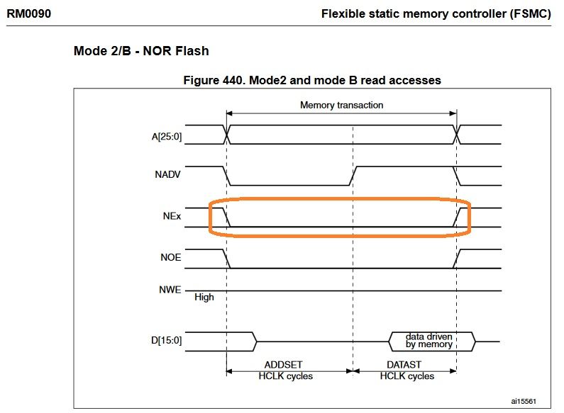

2018-09-13 11:55 AM
Review the state of the pins during the bus transaction. Apply "logic". Remember FSMC_NE1 and FSMC_NE2 will ONLY be LOW during active accesses to the NOR, the entirety of the rest of time they will be HIGH. Only ONE will be LOW at a time.
You don't provide a datasheet or part# for the specific part you're using, but I'm assuming an 16-bit wide device (D0..D15) with address (A0..A25) describing 128MB in total. And in this case you'd connect A25 with FSMC_NE1, because FSMC_NE1 will be ZERO during access to the lower 64M bank, and HIGH when FSMC_NE2 is LOW for the second 64M bank.
