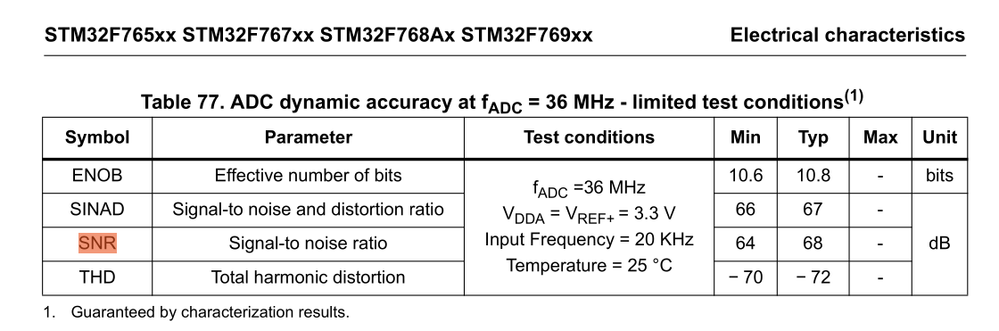

Thanks. Can I get more electrical details on the internal ADC such as SNR, SFDR etc. Also, I am assuming in continuous sampling mode, the same channel can be sampled in a loop?
2025-04-25 6:38 AM
You can find adc specification data in the data sheet for specific part number. Here is an example for F767
Yes, one channel sampling is supported, using timer to trigger adc "start conversion" and dma to transfer results to memory, precision in timing - low jitter is guaranteed w/o uCPU interruption.

Thanks. I could find specifications for SFDR. Is that something that is not characterized for these ADCs?
2025-04-29 12:31 AM
I have no idea, likely SFDR is low for ADC that running in the same package with 3 PLL ( up to 960 MHz) and dozens of peripheral with it's own clock dividers, spectrum contamination just unpredictable.
