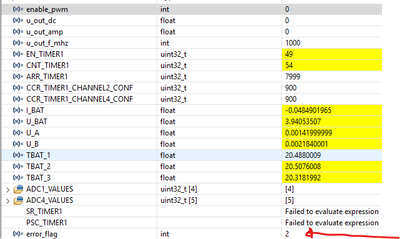

The problem im encountering is the following one:
Everytime the ADC starts, the buffer where all the data comming from the sensors goes is filled with 0. So everytime i try to intiate the program it obiously detects that the values are out of range and therefore i cant initiate the program and the error flag instantly pops up.
Is there anyway i can "wait" for the ADC without introducing any kind of blocking mode in the program?
I think you talk about a debugger view window here.
This is not real-time, mind you.

Yes, ADC1 and ADC4 are separate peripherals therefore, there are two channels of the DMA for both adcs and two buffers on where to put the data incoming from both sensors but both of them are triggered with the same timer for better synchronization.
Would you consider "real time" if in the debbuging window i go step by step in the program?
2025-03-24 6:47 AM
I meant the usual "realtime" displays in debugger windows. Their output is usually not synchronized with anything, and is can be described as "best effort".
Single-stepping might not reveal all runtime issues as well.
