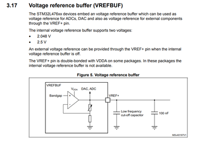

Hi I want to sample low voltage signals with STM32L476 so I figured it would be a good option to reduce reference voltage and I found this part in the MCU datasheet:

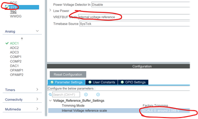

> Is it enough to set it to shift Vref from 3.3 to 2.048 or how should I set my reference voltage to 2.048?
VREFBUF is enabled in the SYS tab. VREFINT is and ADC channel and is not relevant here.
> Also If I decide to use an external Vref can I just connect lets say 1V to Vref+ for MCU to change Vref for ADC to 1V from 3.3V.
No, there are limits on VREF+, see datasheet.

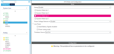

Thank you for the quick reply. I checked the system thinking it might be under there but I cannot see VREF Buffer option.

If the VDDA pin is tied to the VREF+ pin as it is on the nucleo board, the VREFBUF is unable to be used.
2025-03-20 3:35 AM
I am using Nucleo-L476RG. I believe VDDA pin can be tied to the VREF+ pin so that can be the problem because I created the project adding the board.
