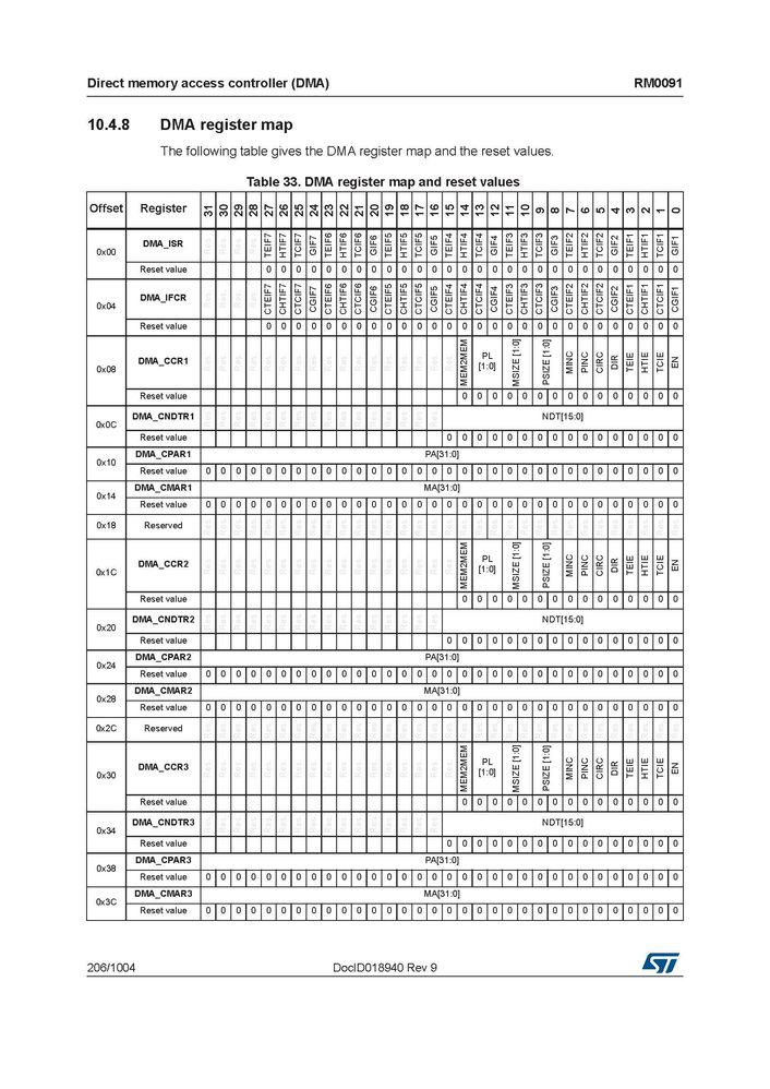

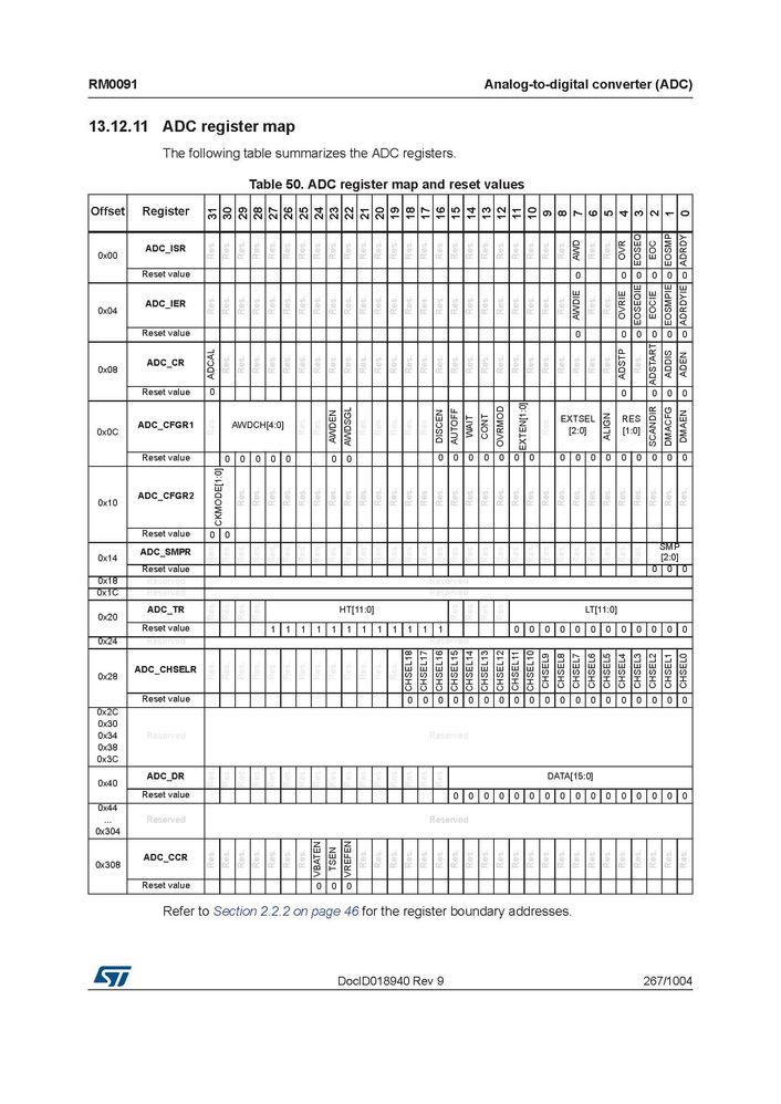

What MCU is that?
Please post the contents of the DMA and ADC registers.
2020-05-14 10:33 AM
stm32f091
Do you mean ADC and DMA register map?
2020-05-14 12:19 PM
I mean the contents of the registers. Then it would be possible to check them against the pages preceding the ones that you have posted.
