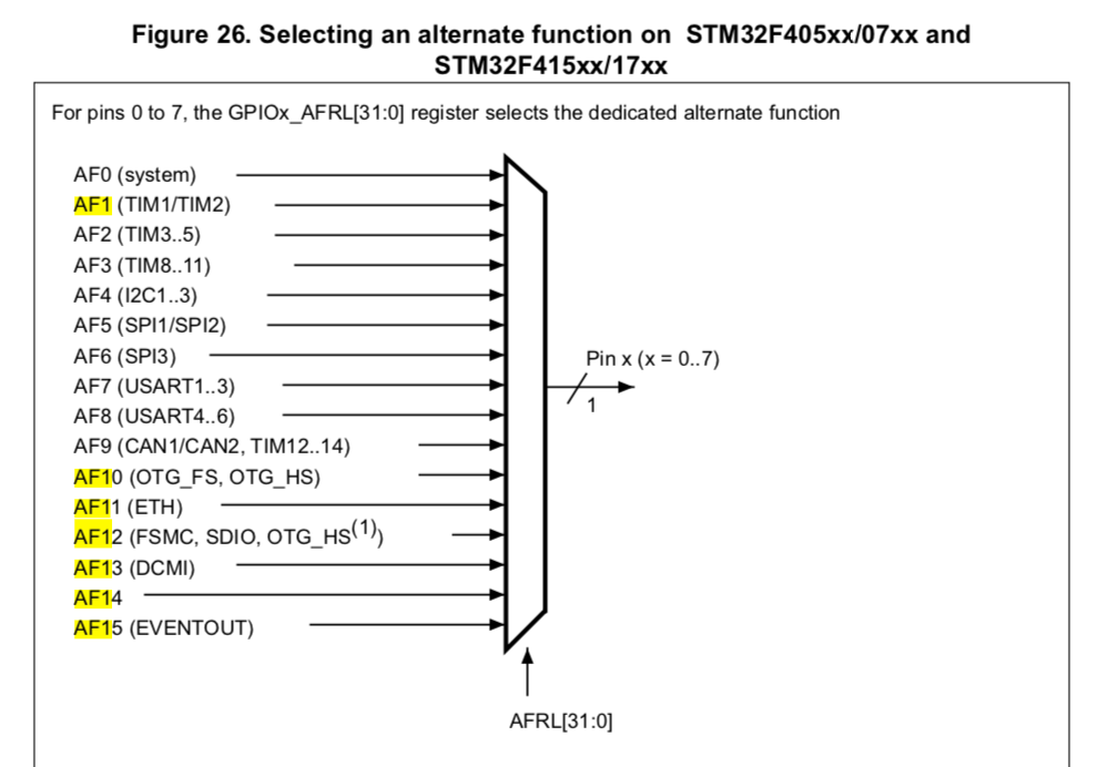

I own a STM32f407 board. I found this mapping table in the reference manual on side 272 (https://www.st.com/resource/en/reference_manual/dm00031020-stm32f405-415-stm32f407-417-stm32f427-437-and-stm32f429-439-advanced-arm-based-32-bit-mcus-stmicroelectronics.pdf ).
For me it seems like PA1 has a TIM1 functionality. Did I made here a mistake ?
(I change then to TIM1_CH2 and TI2FP2 in TIMx_SMCR.TS )
2020-05-12 11:11 AM
That's just a general drawing. The interconnection matrix is sparse. See the table in datasheet I referred to above.
