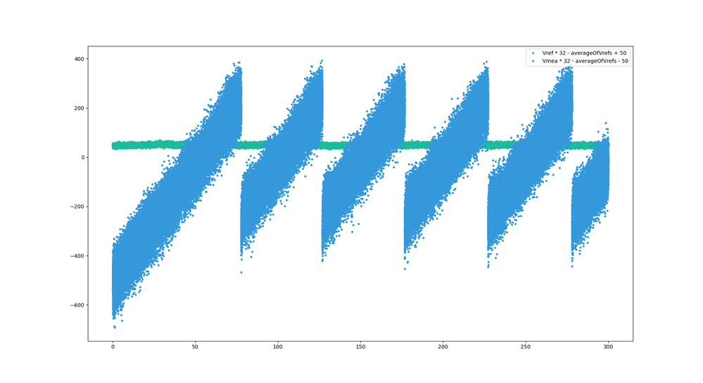

I'm using STM32F303 to sampling the multiple analog signals, and for higher resolution, I was oversampling every channel, but I found out all the signals were ramping with same period and same time.
For figuring out the problem, I did a lot of tests, and the diagram below is one scenario that only sampling interval Vref and one of signals:
[Green: Vref * 32 - averageOfVrefs + 50
Blue: Vmea * 32 - averageOfVmeas - 50
X: seconds]
What's this diagram resluting from? Changing ADC clock prescaler or channel sampling time not optimize the result much.
In general I did oversample 7 signals, they also ramping in same period and same time like the behavior.
Any guys had met with this problems? Any help will be apperciate, thanks.

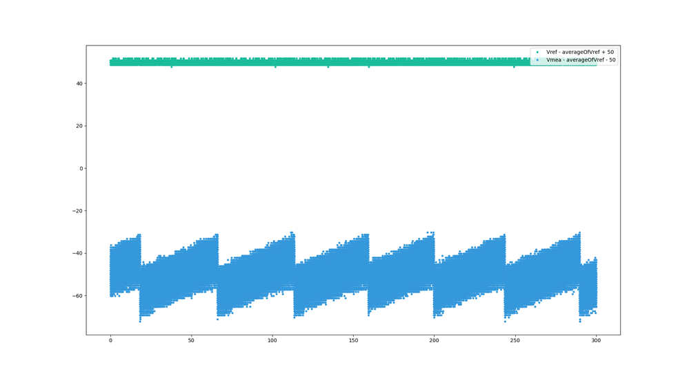

I did test on a Nuleo F303RE board and replace the singal as a floating analog input, so the diagram is showing below:
so, why the data from floating pin is showing same distributing with ramping, I think the source problem is same with I'm facing now.
Still not figure out the reason.

2021-04-06 8:10 AM
I will test these, I update a figure when samping floating pin instead signal source on ST'office evaluation board, the floating data also show ramping slope, this scenerio looks like a exaggerated problem I faced, this might not caused by AVDD stability I think.

2021-04-06 9:38 AM
Measuring floating pin makes no sense. Good point noticed Javier.

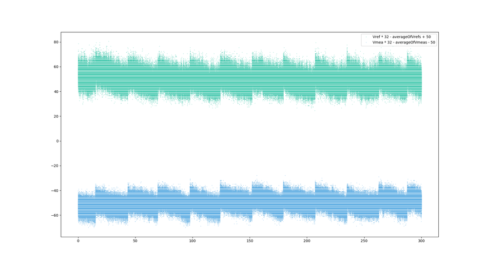

2021-04-06 6:52 PM
It's not caused by code, below picture is a no summing result directly from ADC conversation, it shows the behavior same with oversampling result.
