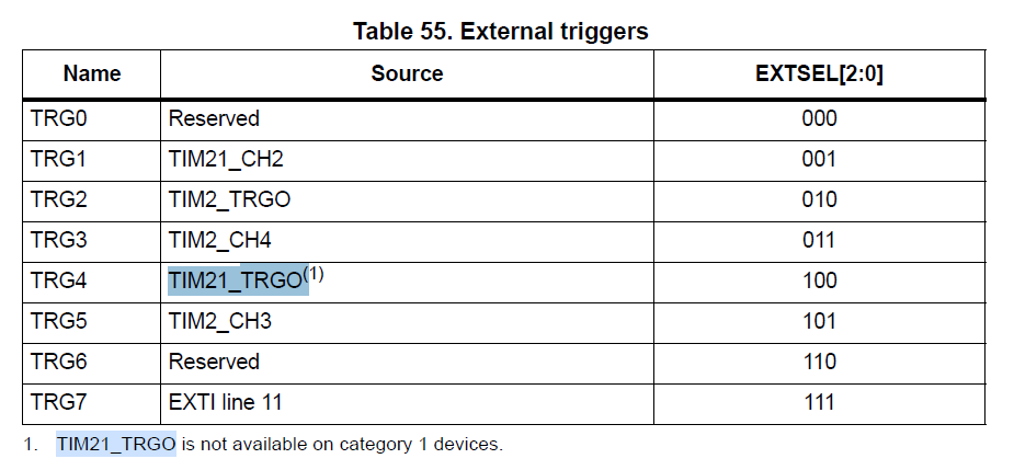

> I see that TIM2 supports DMA request generation while TIM21 does not. Could this be the issue?
No, the DMA request is made by the ADC.
The timer can trigger the ADC on CH2 and (possibly) TRGO. Probably just a bug in your code somewhere. Or maybe your device is category 1, which doesn't have the TRGO option.

And does the TIM21 fire the ADC? Without DMA, you should see some activity on the ADC status bits.
Alternatively, regardless of "class", you should still be able to use the TRG1.

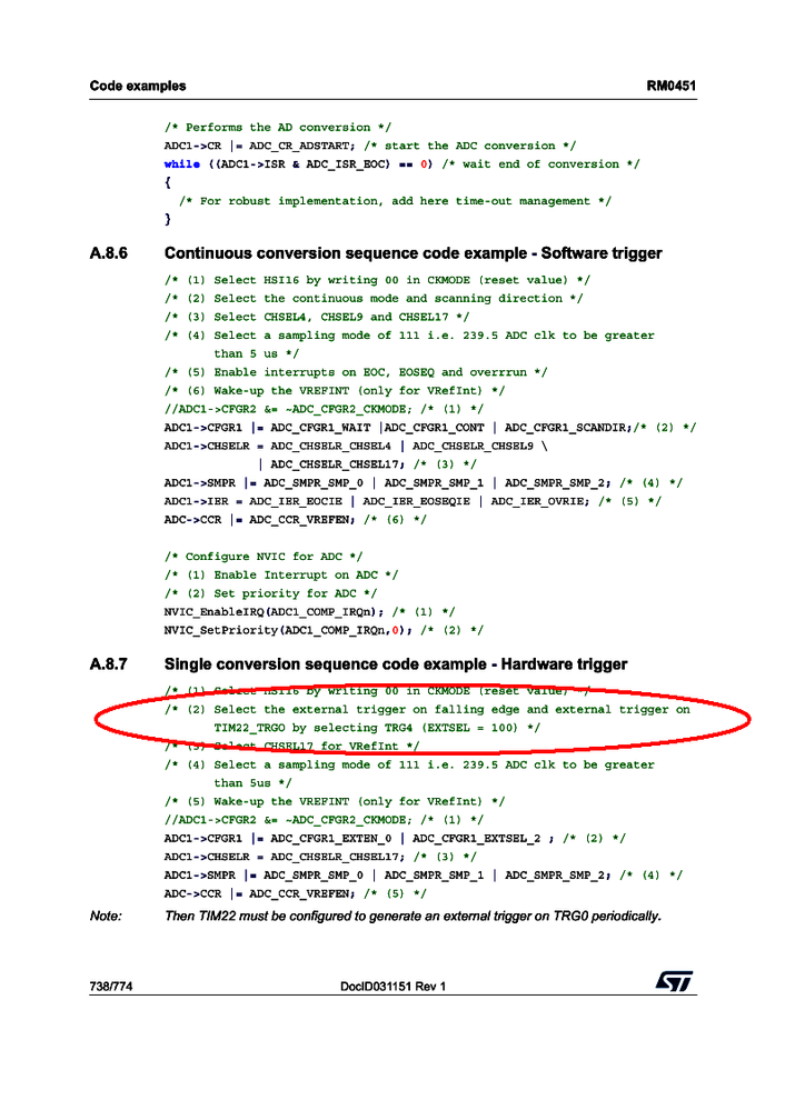

You can also try to use TIM22_TRGO with EXTSEL = 100
Yes, it appears to be a bunch of bugs and errors in the documentation.
