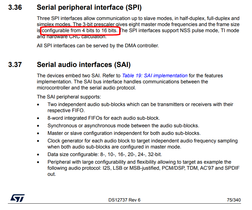

That would be down to the MCU - nothing to do with the board - so check the MCU's datasheet.
The datasheet - and other documentation & resources - will be found on the MCU's Product Page:
https://www.st.com/resource/en/datasheet/stm32l552ze.pdf#page=75
via: https://www.st.com/en/microcontrollers-microprocessors/stm32l552ze.html
But, of course, you can send a 32-bit value as 8x4 bits, or 4x8 bits, or 2x16 bits.
Or even 2x8 bits plus 1x16 bits - if you really wanted to ...
2025-10-01 3:00 AM
@mfgkw wrote:That depends on the comm partner.
The STM32L552ZE SPI hardware can't do 32 bits as such - it would have to be synthesised from smaller "chunks" of 4-16 bits.

@Ozone wrote:most STM32 MCUs support only 8, 16 or 24 bit directly. .
The one under discussion here does 4-16 bits.
