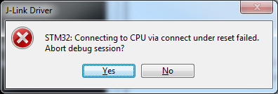

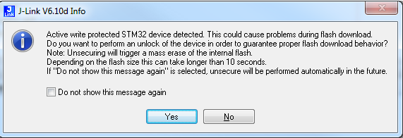

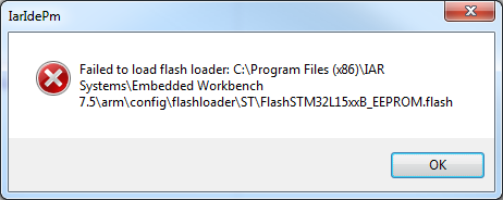

Hi, I am working on ST STM32L151VB-A, I burned a loader which already worked for me, and since then I get ''active write protected STM32 device detected'' also on other application that worked fine.
when I try to connect via J-Link commander I get ''cannot connect to target''.

If pin BOOT0 is not directly connected to GND you can connect it to VCC in order to change the boot mode (see reference manual).
BR.
Danilo

2017-02-15 6:34 AM
It worked!!! thank you so much!
