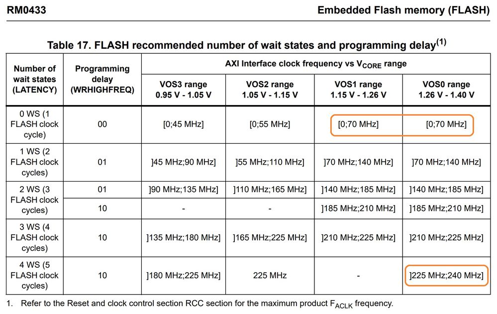

Hey guys completely lost on this one. I have seen many other STM32 chipsets and in the reference manual its plain and simple how to increase it, however when it comes to this chip it doesnt list the Wait state for the CPU frequency but for the AXI peripherals?
Any ideas how to change the clock frequency for this chip particular?
Referring to Table 17 in the reference sheet

The primary takeaway is that the AXIM while 64-bit wide clocks at half the core speed. The dual-ported FLASH is attached to the AXIM, and the wait states on the memory lines is based on the 200 to 240 MHz clock, and the power settings (higher voltage, faster memory).
One wait-state per 60-70 MHz, typically 4 WS for the CPU clocking at maximum
The only memory running at 400/480 MHz is the Cache and TCM, the bus width of the AXIM yielding similar bandwidth, but higher latency.

The documentation is weak when it comes to the clocking, but there is plenty of data in the materials when judged as a whole.
70/1 = 70
140/2 = 70
185/3 = 61.6667
210/3 = 70
225/4 = 56.25
240/5 = 48
The last two are very conservative, a core running north of 500 MHZ doesn't run out of head room. The H7 was designed as a multi-core system, there are models rated to 550 MHz
1) it is an inference based on the maximal speed of everything attached to it, definitely not higher than 300 MHz, and FMC on at least one board can't exceed 200 MHz based on the memory attached externally.
The AHB bus routes straight thru the switching fabric, sharing a common domain. The APBs run off the AHB

4 WS would be 5 cycles total for the transaction on the 240 MHz bus.
The CM7 would be clocking at 480 MHz.
