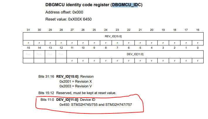

2023-05-30 6:53 AM - edited 2023-11-20 4:22 AM
thanks for your response,
had a look in the reference manual
as i understand this register will not distinguish between those specifdic two (stm32h757 and stm32h747). correct me if i am wrong please...
