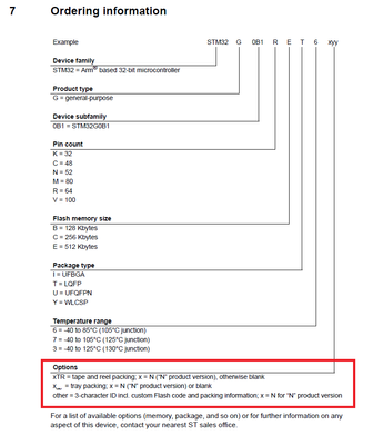

These part numbers STM32G0B1KBU6N and STM32G0B1KBU6 difference is the N at the end, UID, Flash size and package information don't give this differentiation.
So I don't think it's possible to get that information by software.

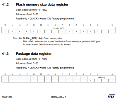

2024-10-02 7:09 AM - edited 2024-10-02 7:10 AM
Here:
