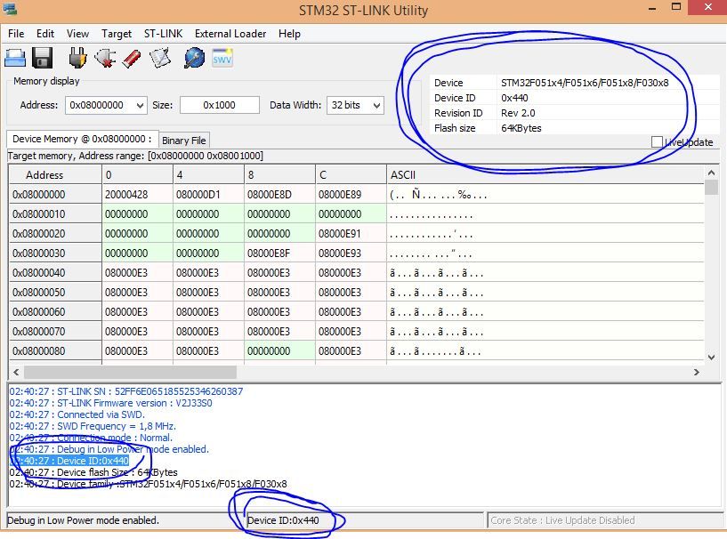

2020-05-27 4:43 PM
When I connect my device via ST-Link program it shows something like below. It maybe what you looking for.

2020-05-27 5:16 PM
But that's the same for every part on the tray...
The OP is talking about getting a unique number that is a subset of the 96-bit Unique ID as that's not random, just guaranteed to be unique for each die produced
