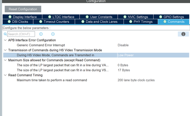

@RobNewbury ,Thank you for your sharing! I tried start DSI -> start LTDC-> initial display in LP mode, The display can't be initialized. I guess F4 might be different from U5.
In your code, DCS long write, DCS short write, generic long write and generic short write are LP mode disabled, i.e. they are all set to HS mode. Is the above code for initial display in HS mode?

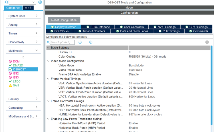

@Kelly3 I'm using HAL_DSI_ShortWrite() and HAL_DSI_LongWrite(), I'm using these in LP mode, I'm not aware that these functions are LP mode disabled, I am definetly using LP mode and they are working for me?
I'm using burst video mode, below is my DSI set up. Check that the VACT value is correct for your display. My other display is 720 pixels and I had the VACT set to 800 pixels, the display wouldn't initialise until I changed VACT to 720. I had thought that the VACT should include VS period in pixel clock cycles, however that is not the case.
Another mistake I had made was to initialise the display to RGB888 and the DSI to RGB565.
I hope that you get your display working.
