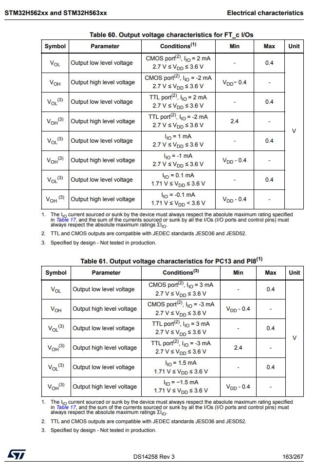

I'd have to say the Data Sheet does a very poor job explaining WHY PB13/PB14 behave oddly. Inference very low sink/source current (1-2mA)
I understand the PC13,14,15 issue where they are on some low power domain.
If the pin's basically floating (OD, HIGH), how can it be leaking enough current that the LED illuminates?
Is the issue here that the LED usage has damaged the part already?

2024-06-12 11:03 AM
Table 60
Where others are 8 or 20mA out of the total GPIO current budget

I concur what described by @AScha.3 the electronic shared should LED On when GPIO is in output 0 level to GND , either OD or Strong Push-Pull to 0 ( which seems working) . If possible to probe PB13 and PB14 and show us the signals in different combinations. These two GPIOs are special for USB type C _c as shared by @Tesla DeLorean and @Imen.D . We need to understand what is happening with PB14 only as it seems a path / strong leakage is created to ground even in input default state . Also sharing full schematics of power pins and boot is helpful. Let us know
