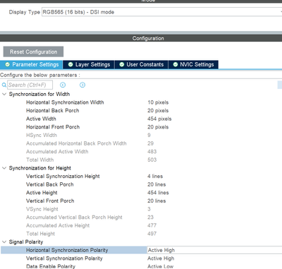

I am using stm32u5g9-dk1 kit for a 454x454 display. The driver IC is SH8601. This driver can work in command mode or video mode since it has internal GRAM. But in either mode, display initialization has to be in LP mode.
In command mode, I only be able to configure it and turn the display one by sending all pixel on command 0x29.

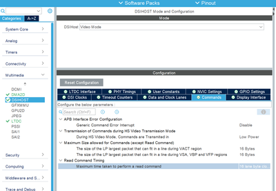

In video mode, command write is set in LP mode as in the following screen shot, and it does not work.

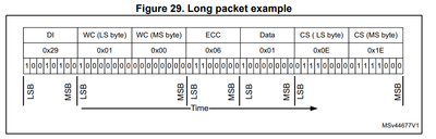

Since the largest configuration data is bytes, total DCS long write packet would be 10 bytes long according to MIPI standard. 1 byte DI + 2 bytes WC +1 byte ECC + 4 bytes data + 2 bytes CS = 10 bytes. So, setting the LP largest packet for commands to be 16 should be enough. And in LTDC configuration, synchronization for horizontal and vertical in also guarantees time interval for 16 bytes long command packets. HSYNC, VSYN, back porch and front porch value are given by display manufacture.
Yet, in video mode, I am not able to configure the display even turn it on using all pixel on command 0x29.
I have been working on it for quite long time. So far, I only can send image data for proper image display by configuring DSI host in " Command Mode via APB Interface", i.e. in LP mode. But the LP mode is so slow. I am stuck in the middle of using HS mode to send image data to display.
If you were able you make your display working with STM32U5G9, may I have some information on which part could be wrong with my configuration? I have been working on it for 3 months, still no clue what could be wrong.
