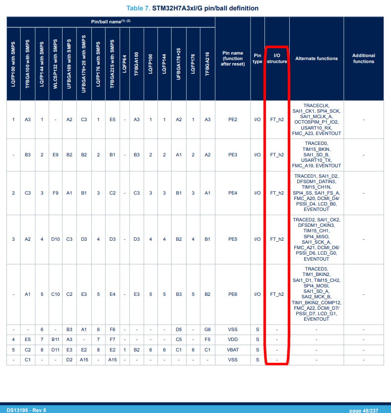

iam working on stm32h7a3zi controller in that datasheet they mentioned up to 164 I/O pins capable of 5V tolerant but they didn,t mentioned about which pins are capable of 5v tolerant

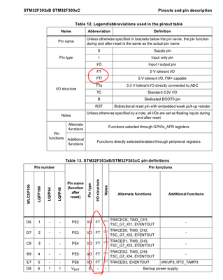

Reading datasheets is an essential skill. Here an example for another MCU variant:

@Arun3 wrote:they didn,t mentioned about which pins are capable of 5v tolerant
As @Ozone said, Yes - they did:
