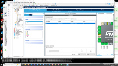

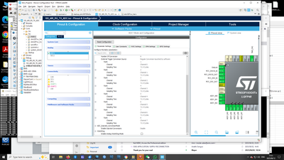

The ADC configuration is
This is the buffer from the IDE

You appear to convert the same channel over and over, or all channels are at the same voltage.
Read out and check/post the ADC registers content, especially the ADC_SQRx registers.
Do you perform calibration before the conversions, as per the reference manual?
