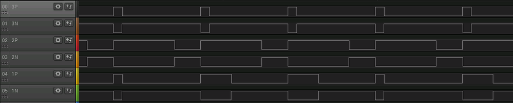

The desired output on each channel should be 10, 35, 70% dutycycle, but its not....
Right now i have random values on the 3 channels.
I am incrementing incorectly the CCRx registers adresses? What could be the issue

CCR1, CCR2 and CCR3 are not contiguous 16-bit numbers, but could be treated as an array of 32-bit numbers. All the duties in your image appear to be around 10%, 35% or 70%, on the wrong channels, but not garbage. Not sure why you are triggering DMA on CCRx either. I think you need to read Page 332 of Reference Manual RM0401.
I recently wrote a driver for an WS2812 LED strip. The data interface is curious: it's basically continuously varying PWM, (but with the duty cycle being one of only two values, representing 0s and 1s in the data). I created a lookup table of the all the necessary duty cycles, and used PWM with DMA to copy the next duty cycle on every timer update (TIM1_UP). I haven't tried it, but suspect that the reference I mentioned helps explain how to set this up for three channels.We’re moving the ST Community to a new platform to give you a better and more reliable community experience.
