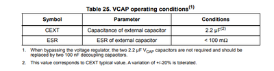

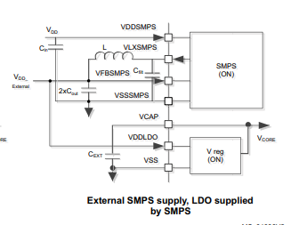

Just a simple question: you write : STM32H747BIT6
but you use only LDO - why? afaik it should be using smps + LDO (for max speed)
and vcap 2.2 uF ....not your many caps...
Try to change the vcap and check (if cpu still alive...).
And no, its not a fake. Maybe its a damaged cpu now.

"but you use only LDO - why? afaik it should be using smps + LDO (for max speed)"
Correct me if I´m wrong but I think for the max speed is only necesary the LDO, but I´m not sure.
I also tried removing the VCAP capacitors leaving only two but no diferent result.
