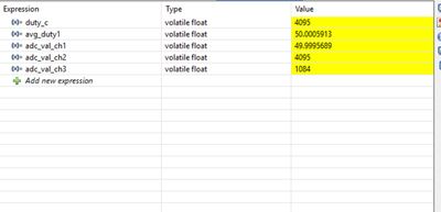

Hello ,

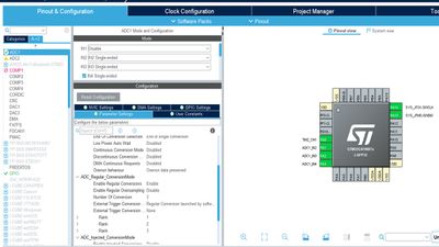

I am working on a project using the STM32G431KBT3 MCU with STM32CubeIDE. My setup includes:
  1. ADC1 configured to read 3 channels (CH2, CH3, CH4) in polling mode.
  2. TIM2 configured in PWM input mode to measure the frequency and duty cycle of an external PWM signal on CH1.
The program runs as expected initially, but when I run the program again, I notice in the Live Expressions window that the values of variables appear to interchange:
  • adc_val_ch1 appears to show the duty cycle value.
  • duty_c shows adc_val_ch1 channel values.
  • Similar behavior is observed for other ADC variables.
 when ADC and TIM2 interrupts run simultaneously the values are interchange, for reafference here I attach my code as well as screen shot of ide settings and live expression.

Could you please advise on:
  1. How to reliably observe ADC and TIM2 variables in real-time without interchanging values.
  2. Best practices to prevent this kind of variable swapping in STM32CubeIDE Live Expressions.
Thank you for your guidance.

Live expressions have always been buggy. They will probably never be fixed as development resources have been shifted to VS Code.

that is ok but ,my all other codes running fine in same platform can you check once code and cube ide setting.
