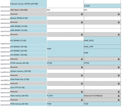

Thank you @BGeor.1 . So, I went ahead and added the gateway, then also cleaned up the Linker script (using the one with suffix "_ROMxspi2.ld", which I have attached). I didn't have the descriptors and memory pool setup on this project yet. I know LWIP is using its separate heap at 0x24040000 which I also just double checked (see screenshot). I enabled the `USE_MALLOC_FAILED_HOOK` flag for FreeRTOS.

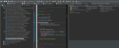

Anyway, I got all that cleaned up, and still the same behavior. The tcpip_thread hangs when it first tries to `LOCK_TCPIP_CORE()`. Is there some memory initialization I need to add for that mutex?
The memory allocations should match this screenshot from CubeMX:

tcpip_init() creates the mutex lock_tcpip_core. With the debugger, you can check whether this lock is getting created properly.
#if LWIP_TCPIP_CORE_LOCKING
if (sys_mutex_new(&lock_tcpip_core) != ERR_OK) {
LWIP_ASSERT("failed to create lock_tcpip_core", 0);
#endif /* LWIP_TCPIP_CORE_LOCKING */
Enable asserts in LwIP to see whether LwIP is generating any asserts. It could also give you some insight on how far LwIP is operational.
