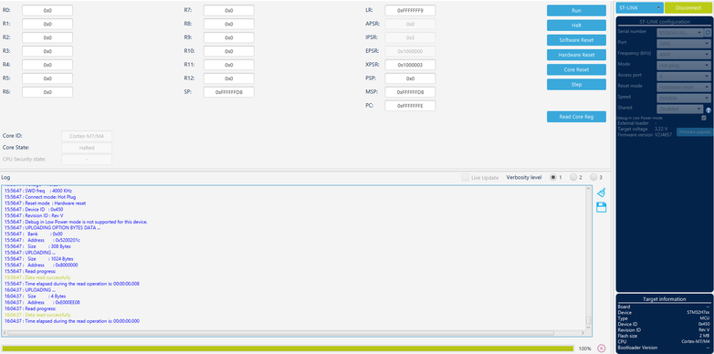

Btw, here is a picture from stm32cubeprogramer whith info of the mcu

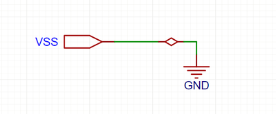

Why separate VSS and GND? A strong ground connection to ground at each VSS pin would be better. I suspect this might be the issue.

Also, VSS and GND are on the same line, (not my best schematic design decision).

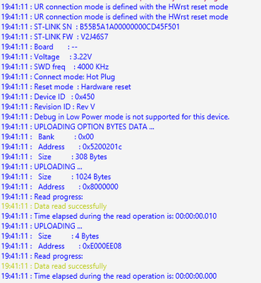

These are the logs that show up when I connect the board

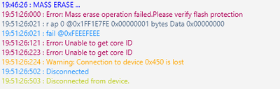

and these are the logs when I try to erase the flash

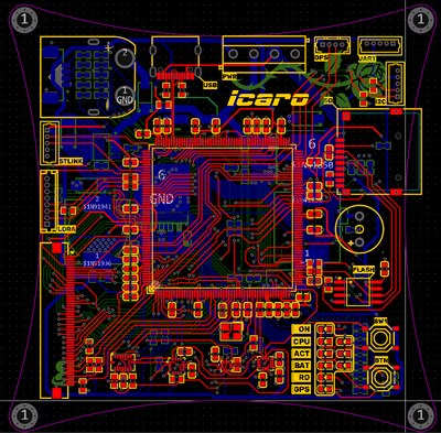

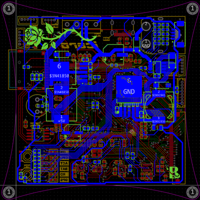

Can you show your layout? Large in-focus pictures of the board with the fixes you made may help too.
2025-09-24 11:16 AM
2025-09-24 7:09 PM
I can't view Altium files, unfortunately.
2025-09-25 2:43 PM
Sorry, I don't know how to share the proyect, do you know what kind of file could I share you?
