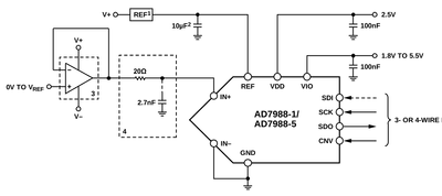

I wouldn't be so sure. Since SAR ADC presents "switching load". Opamp output impedance must be low at very high frequency end, well above 100 Mhz. Only high speed opa's have this specification in DS, and in most cases chart is rolling up and have no practical meaning at all. The best way to drive sar adc is to use high speed/ fast settling time amp (R2R output and capable to run at low voltage 3.3V or adc safety is in danger) and RC network in between amp output and adc input

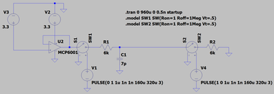

Using LTSpice, we have simulated the OPamp-ADC interaction to find out if there
is any ringing or unstability. The diagram used is shown below.
The opamp used is MCP6001 and the STM32F4 ADC is modelized by its sampling switch resistance
(R1) and its sampling cap (C1).
SW1 is used to model the acquisition phase and SW2 the conversion phase.
The results shows that there is no riging or unstability at the opamp output.
The charging and discharging phases are clean and are done far below the ADC
sampling time.
This demonstrate that the choosen opamp and design is well suited for the ADC driving.
