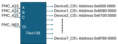

To expend NE/Chip select better to use 3 to 8 line decoder like the 74xx138 or equivalent.
A, B and C inputs of that decoder are connected to the highest lines address of the FMC. So one SRAM bank will be divided to 8 regions equal of size of 8MByte.
G input of the 74xx138 will be connected to one of the NE of the FMC pins.
Example with FMC_NE0 and the different devices address (maximum 8 devices per FMC_NEx):
