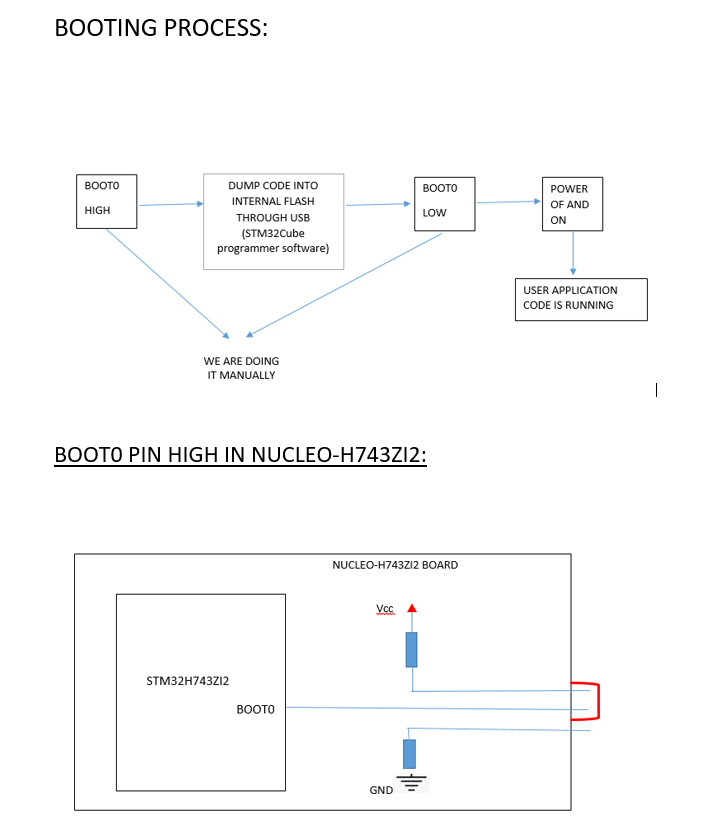

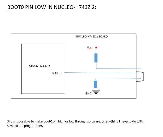

sir,
please find the attached image related to booting process.i understood your reply but not completely. could you please eloborate it.
2022-11-15 3:55 AM
You can't set the state of BOOT in software but you may easily invoke the builtin bootloader from your software. That's what was written above - just do it.
