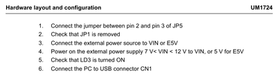

While I trying to use this board, in the user manual they said some changes in the jumper configurations.
In the schematics of IHM07M1 power board, I observed that there is no provision for 5V generations. So, I assumed that I gets 5V from controller board, and I also observed that by closing the jumper J9 in the power board causes direct flow of 12V to the control board, so I opened that jumper and given 5V separately to the board and for running the motor alone, I have used 12V only.

And I also have a doubt that, In the Youtube tutorial videos they are using only one 12V supply, but how the controller board (NUCLEO-F302R8) withstands 12V?
