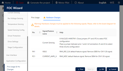

Hello @Duc,
Using MCSDK 6.4.0 Workbench and generating a Nucleo-H755ZI/X-NUCLEO-IHM07M1 project, you will be able to know if configuration is supported or not.
Once project generated, refer to "FOC Wizard" GUI, "Pins Usage & Hw" Tab, "Hardware Changes" part lists all required hardware modifications to be considered.
2025-07-21 9:21 AM
Hello @Duc,

Hi @GMA,
Thank you for your helpful response regarding the need to remove SB80 (RMII_REF_CLK) and SB84 (RMII_MDC) when using the Nucleo-H755ZI-Q with the X-NUCLEO-IHM07M1 motor driver expansion board.

Hello @Duc,
1. For Motor Control use case, there is no impact.
2. You can order a second board for Ethernet use case.
