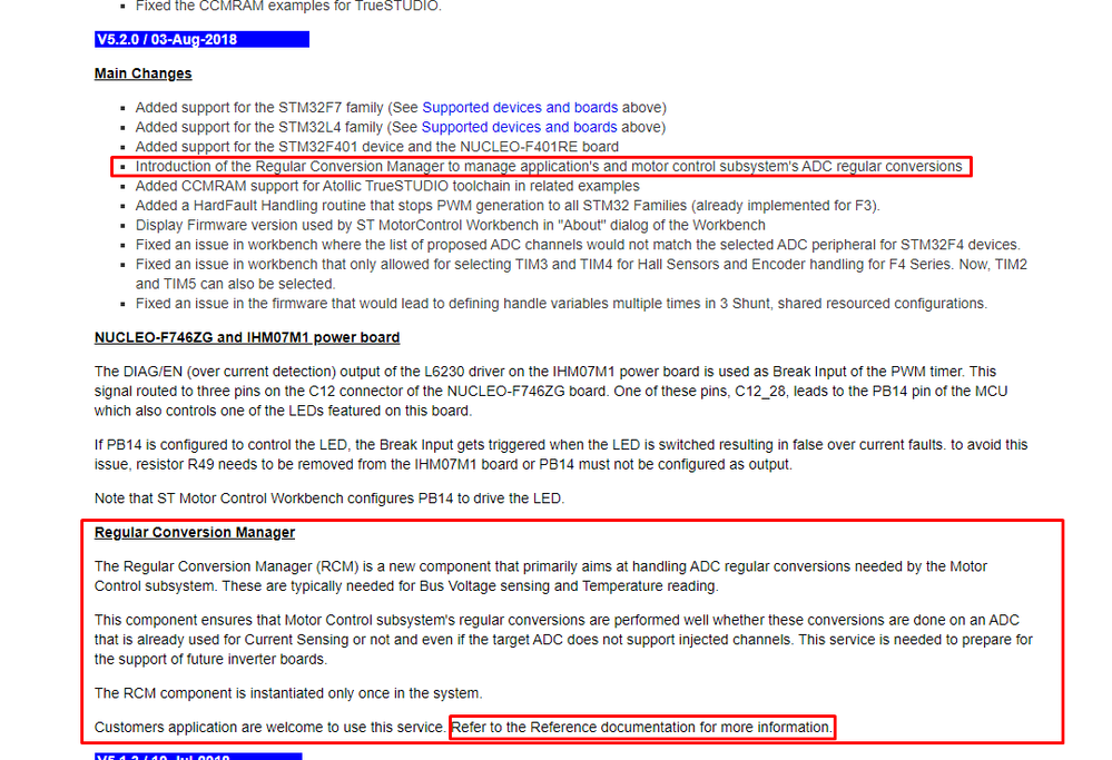

This module only has one ADC peripheral and I need to use it in my application. Looking around, I have found that the Regular Conversion Manager (RCM) might be exactly what I need for this situation. I can see in the release notes that this feature was added in the 5.2.0 version:

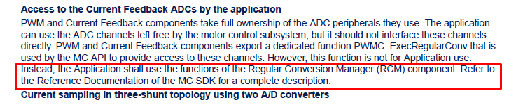

They say to "Refer to the Reference documentation for more information.". So I looked at the documentation for my version which I found in the motor control worbench under "Documentation->STM32 motor control SDK5.x - Firmware". In this document, I found the following information:

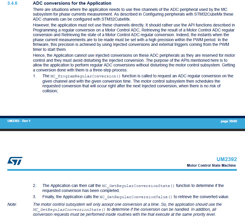

and also:
