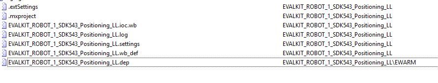

I have only removed the generated file that is indicated in the attached picture “ToBeRemoved.JPG�?. These files should be replaced by your compilation, but to start with a clean environment I prefer to delete all the not required files.

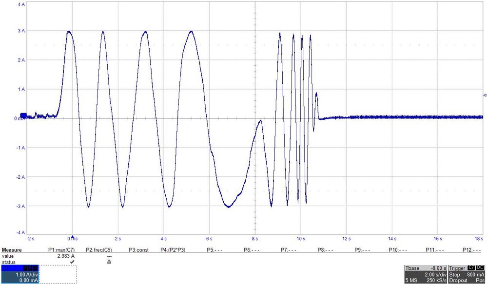

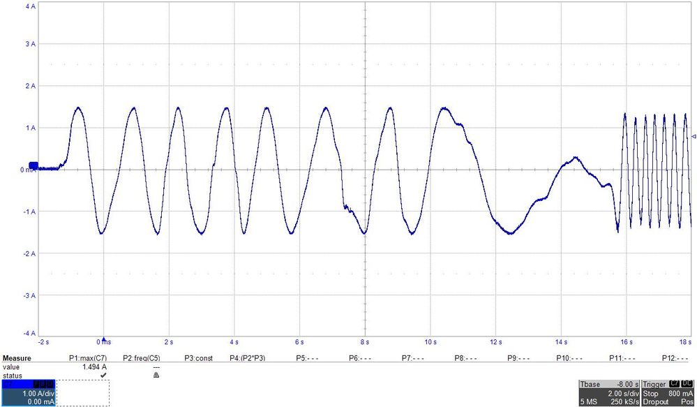

In this condition the motor is producing a current peak of 1.5A in the motor phases (take care not from the power supply) and modifying the two files: drive_parameters.h and pmsm_motor_parameters.h (that I’m attaching) the motor is producing a current peak of 3A.
To verify it I just run the FW, wait for the alignment to the zero position and then I moved by hand the rotor looking to the produced current using a current probe put on motor phases A. And I get the two attached captures.
