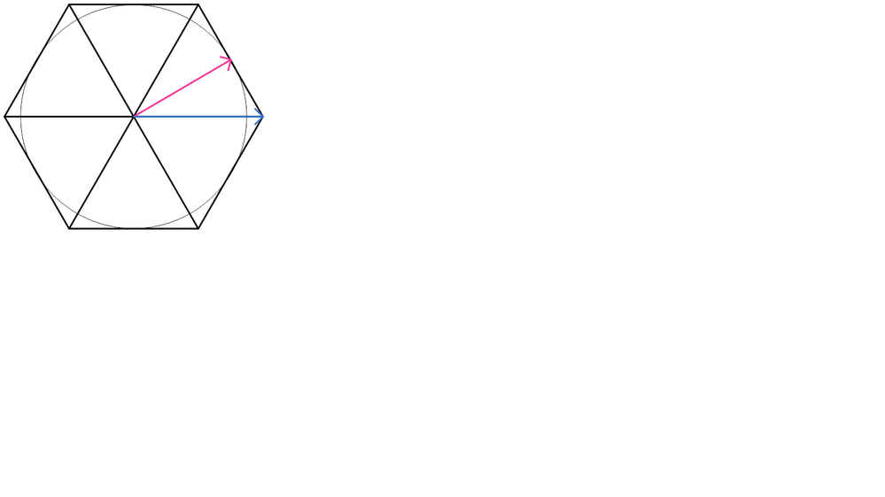

Hello @THA.1 ,
If you look at the picture above, the blue vector is the maximum voltage for one phase. As you mentioned, it is 2/3*Vbus.
The pink vector is the maximum reachable without doing overmodulation. It is sqrt(3)/2*Blue vector, then, sqrt(3)/2* 2/3*Vbus = Vbus/sqrt(3)
As sqrt(3)/2 is the full scale, we set it as 32768, then sqrt(3) is 65536.
If you substitute sqrt(3) by 65536, you end up with the Pink vector = Vbus/65536
I hope it is clear now.
Regards
Cedric
2022-03-09 10:32 PM
Hi Cedric,
Thank you for your answer.
I can't understand the last two descriptions:
"As sqrt(3)/2 is the full scale, we set it as 32768, then sqrt(3) is 65536.
If you substitute sqrt(3) by 65536, you end up with the Pink vector = Vbus/65536"
If Vbus=24V, what does it mean "the Pink vector = 24/65536" ?
In my terms, the Pink vector is of the full scale in [s16V] unit, that is 32768.
Vbus/sqrt(3) [Volt] = 32768 [s16V]
Then,
1 [s16V] = Vbus/ (sqrt(3) * 32768) [Volt]
My point is, this unit conversion factor from [s16V] to [Volt] should be the transfer function of block A. It is differently expressed in page 12, document UM2392 as (12) A = Vbus-dc / 65536, which leads to the different PI gains.
