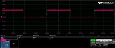

The scope capture below shows the 1,400 RPM motor HALL or BEMF (brown trace)
Motor Speed in RPM = 2 x HALL Freq (or BEMF = same Freq ) * 60 s / pole pairs = 2 x 70.17Hz * 60s / 6 = 1403 RPM - matching the shaft speed with 140 RPM with a certified and confirmed 10:1 gear

In this Shinano motor use case, the targeted speed is 1400 RPM. The motor has two pole pairs, which means there are two H1 signal periods per mechanical rotation as described here. The HALL H1 signal was measured.
Motor speed (RPM) is calculated using the formula:
Motor speed (RPM) = (frequency of Hall sensor) × 60 seconds / pole pairs
For this case: Motor speed (RPM) = (1 / (21.38 ms)) × 60 / 2 = 1403 RPM. This value matches the reading reported by the tachometer.

Q1. "Does rotating the shaft by hand, there is 3 or 6 HALL H1 period per rotation on your side?"
A1. There are 3 periods for HALL H1 with 1 manual turn (30 with the 10:1 gear).
The equation Motor Speed in RPM = 2 x HALL Freq * 60 s / pole pairs is verified for 6 pole pairs, we have RPM = HALL Freq * 60 / 3 (for 1 motor turn we have 3 HALL periods) = HALL Freq * 60 * 2 / 6 = 1,400 RPM
