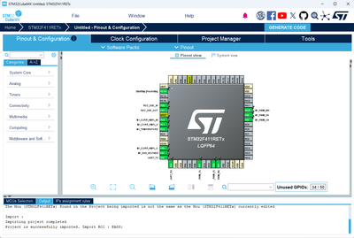

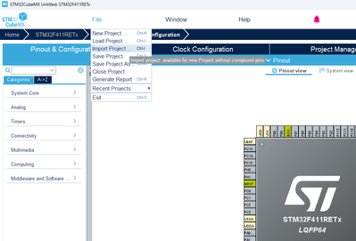

Hi @GMA, Thank you for the suggestion. I tried to do the above procedure in the IDE for F411RE. After import the project, pins are not configured on CubeMX tool. Where can I deactivate OCP on F401 project as first step.
Also, would like to know
1. How can I enable IHM08M1 middleware on CubeMX for BLDC motor.
2. How to configure F411RE + IHM08M1 as work bench setup on MCSDK workbench tool.
Please help me to spin BLDC motor on F411RE.
Thankyou
Hello @omkar62,
After importing the F401 project into the new F411 CubeMX empty project, the CubeMX display should show all I/O configurations.
